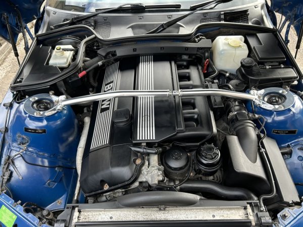

This is Izzy, a 2.8 that was going to be for an engine swap, but I don't think I can justify the risk of ruining two cars plus all the effort of keeping insurance/DVLA happy, mileage rollbacks etc. Also the Atlanta Blue is nice, but I think it looks stunning in black!
So sadly this marks the end of Tandy's journey! 😢 I am still deciding what to do with it, it's on 183k miles so I think I'll struggle to sell it. I'm going to transfer a bunch of stuff across like the interior, angel eye headlights and hopefully the new roof!
