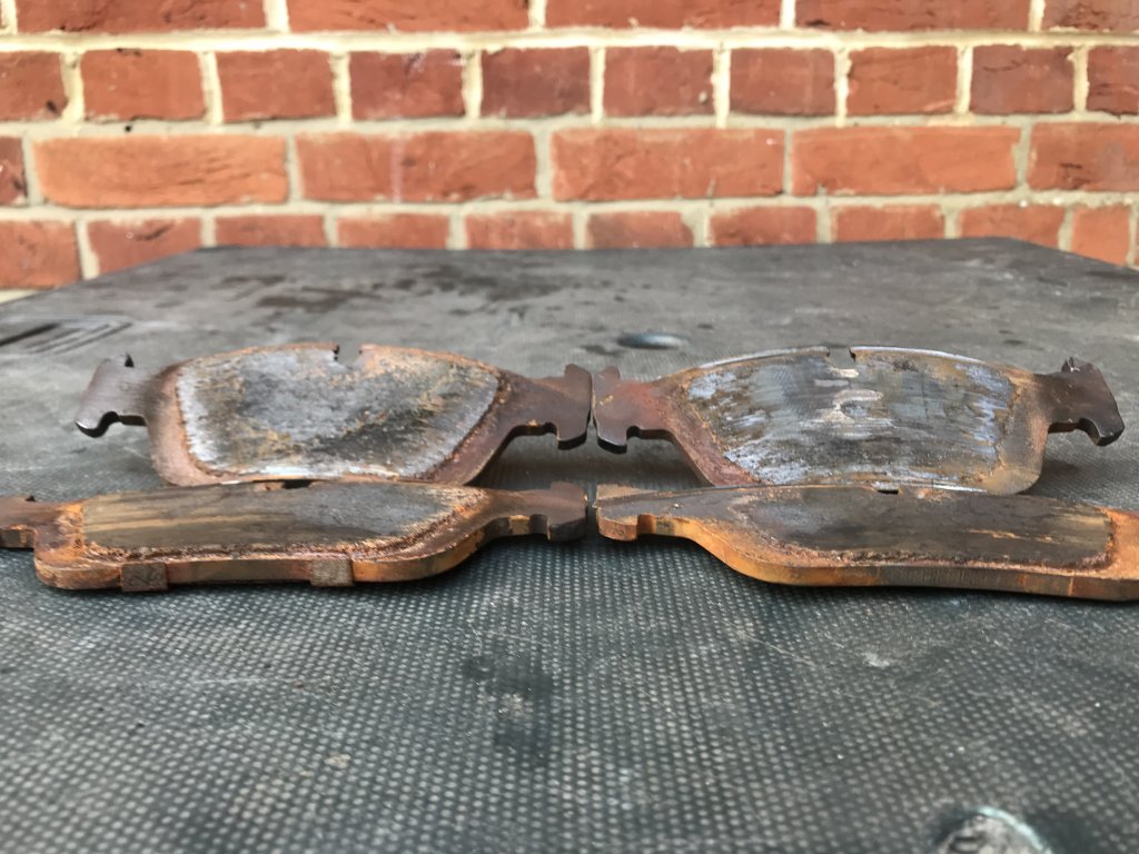

I’ll need to upgrade the rear pads so will shop of the disc and check. What pads do you run on the rear? EBC yellow were crumbling on the rear after Lydden so think they could with a as bit of cooling as well..
oooh a machine shop under control-I’m having pictures of @GazHyde locked in your basement slaving away with an angle grinderThat's a cracking find with the gearbox. All mods I can do myself now have a machine shop under my control. I'm not that fussed with a 6th gear but if the parts are cheap enough we could sit down and price it all up.
I run stock brembo rear pads, I get so much stopping up front I can late brake most corners. I've never had any issues with the rears even over the whole weekend on the ring where most stopping is done from above 100.
