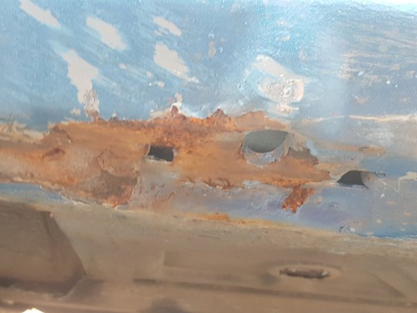

3 years ago I took the passenger sill covers off and gave it a bit of a temporary repair and built the ends up with some body filler which has held up surprisingly well considering there was nothing behind it supporting it.
Both sill covers have had to come off again as I realised I hadn't done a great job of protecting the actual structural sills underneath. Wanted to get this sorted before the respray and the new sills go on.
Lots of rust on the underside especially behind the jacking points. Some of it has crept underneath the seam sealer so would be hidden unless you removed all the seam sealer.
Thankfully caught just in time as it's all still very solid, now I've started the really fun job of grinding it back down to bare metal, treating it with a rust converter, painting it with metal paint and then hopefully spraying some sprayable seam sealer to protect the sills and underside from future corrosion.
Going to be an expensive few weeks :rolleyes:
Offside front once grinded back down to bare metal
