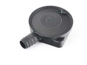

Then clean the Crankcase Ventilation Valve with carb cleaner.

the valve looks like the one in the first photo and is located on the right side when you stand in front of the engine, behind the intake “snail”
Check these first and then we will trouble shoot the coolant.
