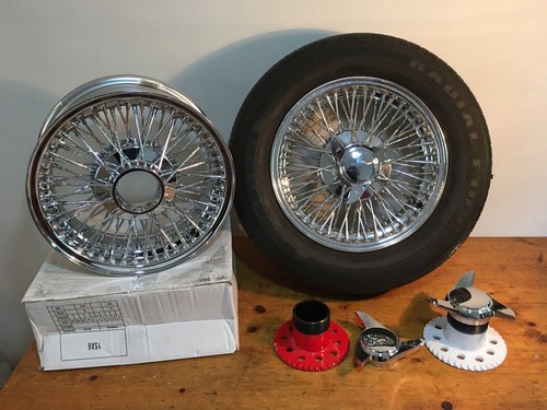

I can supply chrome wire wheels. hubs and spinners designed for the Z3 if you need a seat. Tubeless of course and you can still use the existing space saver tyre as well if you want.
How much would you charge for them?

Set of 4 wheels, hubs and triple eared spinners are £1650 but can offer £100 discount to forum members.
As fitted to my 259swb in my avatar.]They use a peg lock design, not splines so will take a lot more power.
The hubs are held on with the original BMW wheel bolts so the hub can be removed at the side of the road in case of a puncture and the original space saver wheel fitted.
Would you have a photo?

jaguartvr
Jan 9, 2017
95
Here is a link to my eBay listing with photos. The wheels were designed to fit the Tribute 250swb and the DNA 250 California. I can also supply parts for the DNA California, interiors trim to a full kit.
