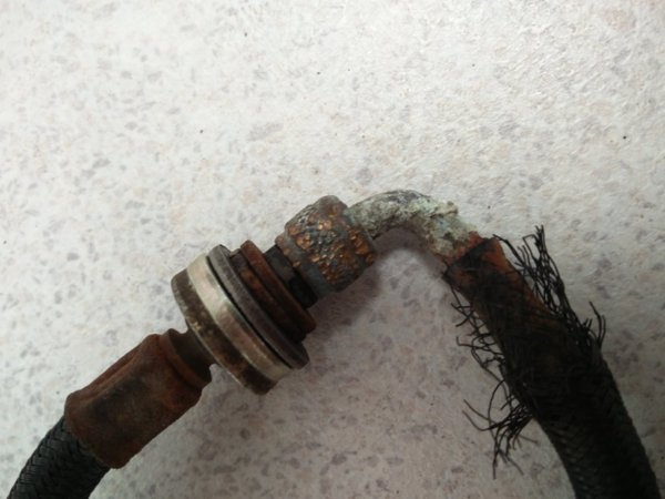

Here is what I had to work with:
I started by giving the entire carrier a good scrub with some soapy water. I then followed by sanding the carrier down using a dremel with an 80 grit flap disc (I didn't have anything lower than this, else it would have been used). After about an hour of sanding the carrier looked a lot better - in some spots the corrosion was so extensive that I had to sand back right to bare metal. I then wiped the entire surface down a few times with rubbing alcohol.
