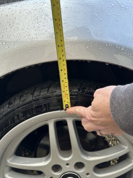

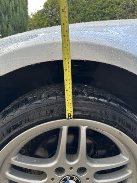

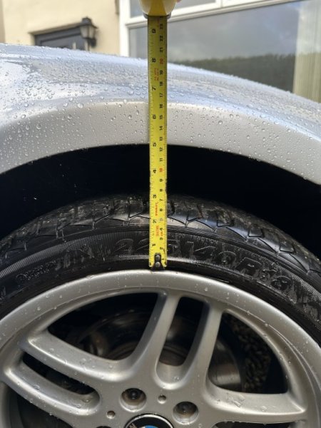

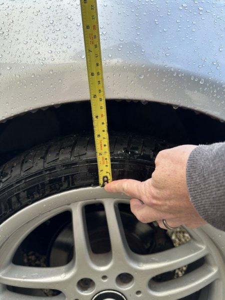

Wow. Thank you. It is VERY much appreciated. I wish I could do all that myself but obviously reliant on the garage. I’m going to just go ahead and try to tell them how to do their job but that’s a tough one. I maybe should leave them to it first now rather than nudge them in this direction??? Tough call

Strange one, this. If suspension parts fail, they usually make the suspension 'collapse' not 'raise'. It's a simple thing called gravity!!
Nearside front 'lollipop' sheared/ snapped/ come adrift??
I have to adjust my front coilovers (again) tomorrow, so will have a closer look.

I suspect someone has fully tightened the nuts and bolts when the weight was off the car, or you have the wrong springs. I would expect this if the springs are for a car with a heavier engine

The problem with uneven ride height was the reason why the OP went to a garage, if I have read the thread correctly. They changed the front dampers and springs and the problem persists, possibly worse, so it is highly likely it isn't a spring/ damper issue.
Yes. I’d have to agree. It’s just accentuated the problem I think.
