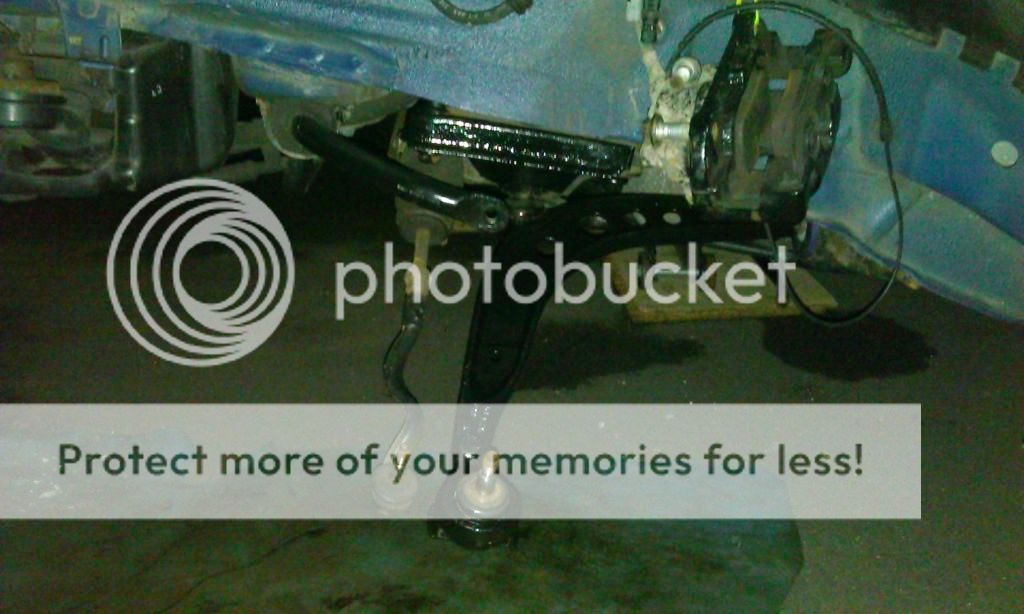

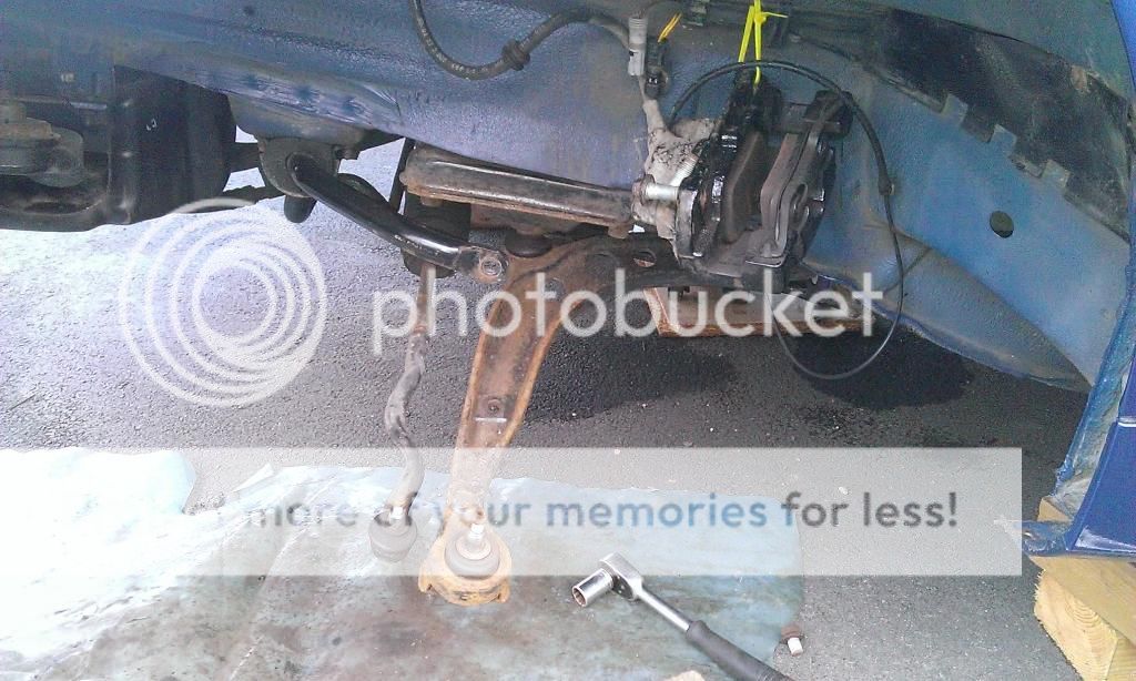

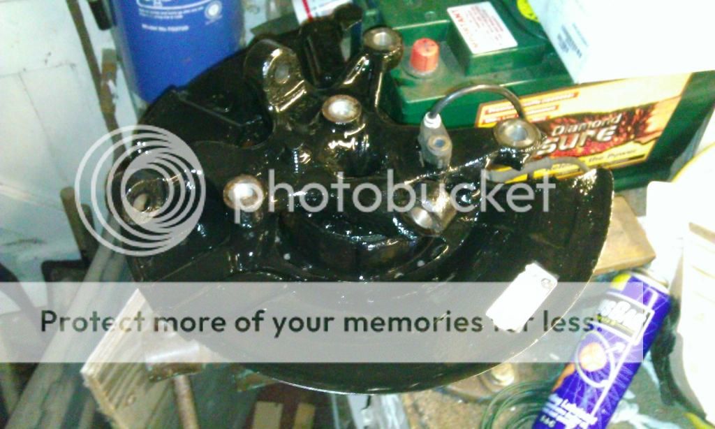

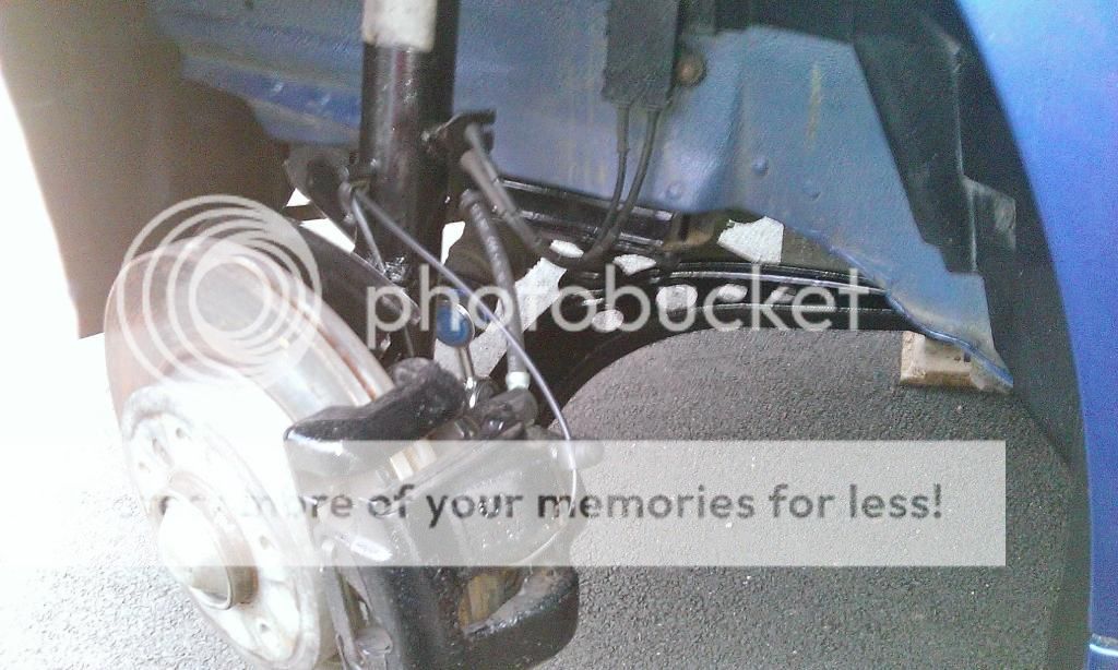

Tidy up the front suspension.

I lowered the car onto 2 pieces of 8" x 2" timber I have gave me another 4" to reach under. I had done the bolts up most of the way so only needed half turn to finally tighten.

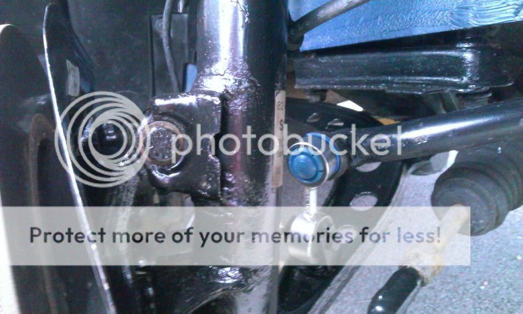

The drop links for the Z3M have a ball joint both ends but are longer because they bolt to the front strut whereas the standard Z3 ones fix to the control arm into a 'U' shaped bracket.

There are also after market adjustable ones for use with the hard setting on H&R ARB, they have a rose joint so swivel, I don't see any reason they could not be used as standard other than they have no dampening material.

Missed them you learn everyday. As you say they must just be a bit more direct in operation. I knew you could get the polybush inserts for the standard links.
