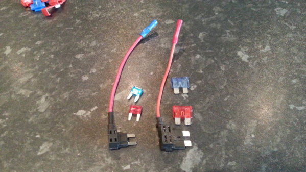

I used two of these cables from eBay,
http://www.ebay.co.uk/itm/311523067514?_trksid=p2060353.m1438.l2649&ssPageName=STRK:MEBIDX:IT
1 I removed from the Z3 and 1 which I bought to fit in my Touareg (but never got round to doing) I cut the old one down to about 12" and grafted it onto the other one which in turn was cut right down to reach the fuse box where I'd installed an Add-a Fuse into an ignition fed fuse port.
It turned out to be the standard blade fuse size, not the micro one. With it installed into the fuse box I connected the power wire to the cig lighter sockets wire and earthed the return onto the steel work by the fuse box. Next job was to secure the 2 plugs and all the wires to prevent rattles and chaffing.
Lastly, I refitted the glove box and under cover, Oh and closed the bloody ashtray.
