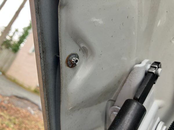

Greetings all,
My 2001 Z3 came with the Aero side vents and I'm wanting to remove them. They are attached, seemingly from the factory, with completely different clips than the other two styles (the standard and the M style). Can anyone more experienced with body work tell me how to remove these without damaging them? The only thing I can think of is to very carefully cut each metal clip off with either fine-nosed snips or a dremel and avoid cutting into the plastic columns.

Yeah, good call. Though I've found other threads not car related where this is discussed, and they basically suggest the same things I'm contemplating. Or to use a pick to bend the teeth up one by one - but I don't think that would work well here.
