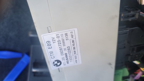

My 2014 Z4 has the same fault code but my trunk is accessible. I tested the signal pins 7 and 10, both have 11+ voltage. I will test them again to make sure I didn't count the pin number wrong. If not I will test all the brown signal pins to see if any of them 0 voltage.
