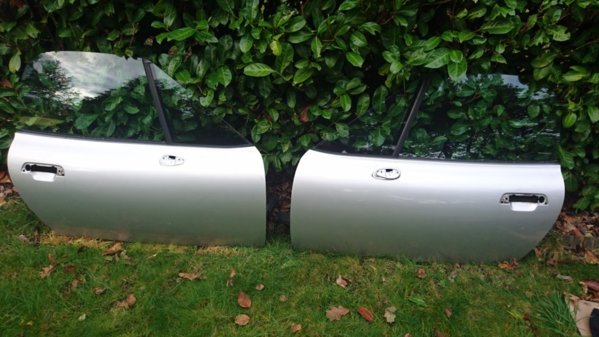

Note - Door does not have to be removed from car for this to work - I just had these doors from a breaking project.

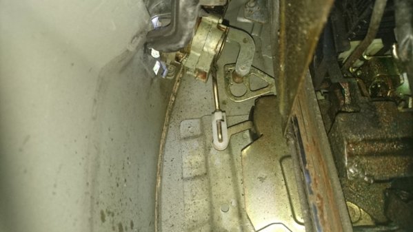

This is what the inside of the door handle looks like, the goldy (pitted) coloured 'slider plate' mentioned later can be seen here - about 6 inches long running horizontally just below the door handle hinge (slightly U shaped).
You can also see the handle's connection to the door actuator on the left of the picture which needs a jiggle later (on passengers side - drivers side has a linkage too).
The plastic plug that is in step 1 can also be seen on the left for reference.

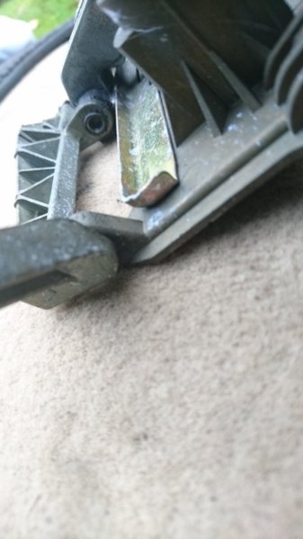

Little retaining clips and the (now moved) goldy pitted slider plate can be seen here. With one plastic tab now clearly released from slider.

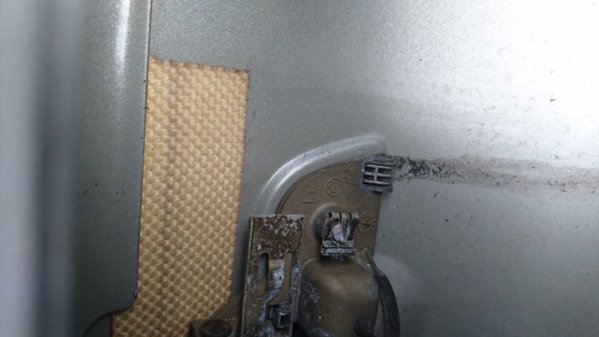

4th - From inside of the door - with a flat screwdriver gently lift upwards and push sideways the locking gadget (small square item straddling a pin in middle of this picture) holding a retaining pin (loose in picture above).

6th - The only things holding it on now is
- The stud linked to the door actuator by a push fit - needs a jiggle - you can see the large cavity it has for this purpose
- The electrical connector for central locking - not shown, a black cir-clip needs to be removed from the yellow connector before it with pull apart.
- A skinny gold linkage - the white retaining clip needs to be prised off sideways with a flat screwdriver then it just falls off
These need to be gentle prised open in predictable ways.
