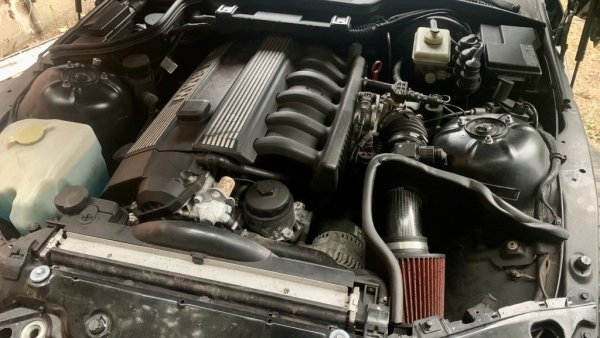

- stay tuned) I do have oxidation on some of my bare metals. Before I get ahead of myself, first a little 101 on my lil treasure. He’s a 1998 2.8L six cylinder roadster. The gentleman I bought it from added M model accessories but it is NOT a M model. It is the 2.8. I have the stock double over-head camshaft, mounted in line 6 with my tranny bolted on the rear end. It has been upgraded with a K&N cold air intake (cone filter), as well as a scorpion exhaust and tail pipe. Aside from that slight oxidation on my metals, everything is intact so far. I had a cracked intake boot which I replaced with an OEM boot I managed to get my hands on. However, the lower hose leading from the bottom of the intake boot to the side of the engine is cracked at the top where it meets the boot. So I will have to replace that as well. And the main issue I’ve struggled with is the ongoing hazards. I’ve read allot on it, and I have plenty to troubleshoot and try regarding that issue. It is why I have left the battery disconnected. Any input on experience with that is appreciated!

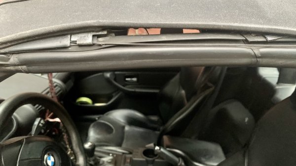

I do have the usual glove box sag, and although I don’t experience rocking seats I DO have the bushing kit for the seat issue which I intend on installing because I have to remove my seats regardless. Why? You may not be able to tell from these pictures, I was too ashamed to take any of it before 🫣 but due to this little problem with my top, as well as a missing rubber retainer in the rear

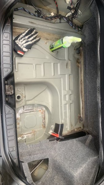

Currently, I’m working on the trunk. I sanded/brushed most of the rust out, a few more spots and it’ll be totally removed
Once this is completed and sanded I will prep, apply rust prevention and paint. I’m currently looking into using Rustoleum to aid in removal, and POR15 with the top coat for rust prevention. Opinions are welcome as always.
