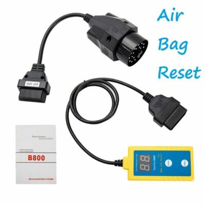

The C310 won't do airbags, but I think it does other stuff like ABS fault codes
you can get a stand alone Airbag one for about £15 off eBay, which will also come with the round pin connector adapter that you will also need for use with a C310
see here:
