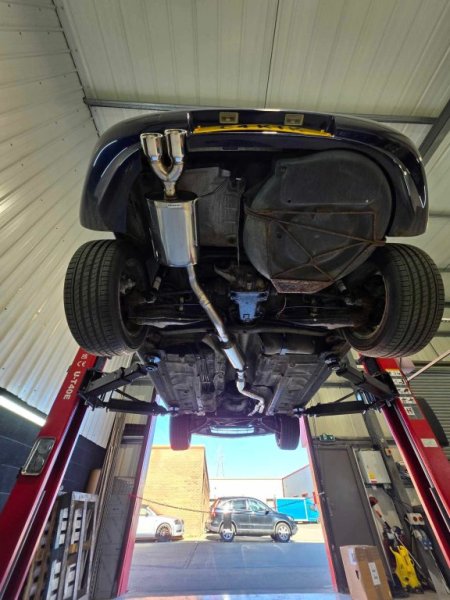

i wanted to share some pictures of the new exhaust I have fitted and ask for help with issue I came across.
i started to having brake warning light coming intermittently and after putting car on the ramp I could see a brake fluid leak from one of the brake pipes( one that goes from above trailing arm and then all the way under chassis next to side skirts. Can someone recommend where to buy them (copper ones) so I can get that replaced.
