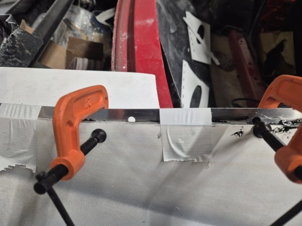

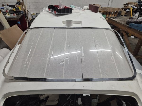

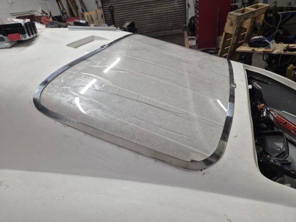

Started to install the Grassbank rear window this week. Have cut out the hole using the guide in the original body mold lines. After cleaning up I've bonded in the metal channels to the inside. Lots of cheap clamps from Amazon. The trim holes are slightly hidden under the body as advised.
On
trying the trim afterwards the holes could be further under the bodywork.
The acrylic screen is in place but needs a little trimming. Will continue this week and fix.
mittaw
Apr 1, 2024
44
Got the trim sorted today. Not a job for the faint hearted first time around. Takes quite a bit of work to get the screen trimmed to match the cut out, and with the trim detail too. Have got it 90% there. There's still some trimming and shaping to get it sitting on the body flush and correctly. Some small areas where I might need to touch the body up with some filler to get the lines right, but these are minimal. Will try and get if all sitting flush the weekend and get the centre trim sections in place correctly.

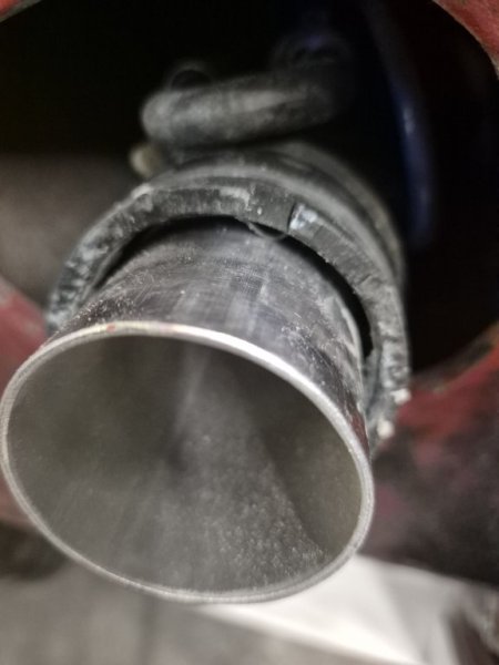

Body on and sitting now to set. Long day getting all trimmed. Fuel filler to the wing was a nightmare I don't want to do again in a hurry. Did if before setting the body but working alone it was very difficult without being able to get the body off with an extra set of hands.
Used a short length of aluminium pipe to insert into the existing filler pipe. Removal of the existing filler section is a fiddly job but a bit of force helped it out. The aluminium tube slides into the existing filler and stops as the existing filler pipe narrows so it has a natural stopping point. I thought about using a larger 90 degree section of fuel pipe that sits over the existing fuel filler pipe but I wanted a more direct fuel travel into the tank and didn't want fuel sat around any join with the bigger pipe. I've seen it done both ways.
I made a gasket out of fuel resistant gasket material to push around the edge then sealed it around the gaps. The gasket will stop any sealant running down the outside but didn't over due it with sealant in any case.
Another home made gasket over the top of the sealant and taped for good measure while everything set. Was tider tha. The image shows in the end. Fitted some flexi fuel filler hose to the aluminium pipe with a little more sealant and then connected that to the fuel cap on the wing. I have to bend back some of the body metalwork so there was no part of it touching the fuel hose.
I attached some old boot rubber to the body just to give some extra protection from metal work. I also put a length of larger thick fuel hose around the flexible section. Ive gone over the top but I just want to be secure.
