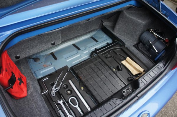

I'm on the lookout and am going to see a car nr Leeds, hopefully at the weekend. At £6k its good value too, but I dont want a pup!
Can anyone tell from pics if the boot floor welds are cause for concern. Look like they're on their way to me?

Yes there is one spot weld there that looks as if it has popped judging by the rusty look. You really also need to inspect the ones going down the left side under the boot trim to get a truer picture plus an inspection from underneath to see what condition the diff hanger is in will only give you a true indication of the extent of the damage. I wouldn't get too worked up about it though as this could really be a good bargaining point as it can be repaired for £2-300. Softtop wise to replace you are looking at £3-400 again depending on how bad it is you may not need to replace immediatly and maybe look towards doing that next winter and just enjoy it for this summer as you will have it down most of the time hopefully anyway.

The boot floor can be welded for £200 but if the damage is severe and the diff unit has to be removed this is far more costly!

The floor looks like it has a crease in it running from the popped weld towards the right of the grommet bulge. This will require strengthening.

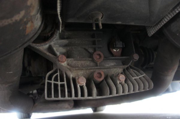

The diff picture is of no use as you have to get right under and look up at the boot floor to see anything. If you arrange a viewing ask if it would be possible to get the car up on a ramp when you go to view it then it will be easier but don't worry if they can't I will bring a mat to lye on. Also you need to hear the engine started from cold so ask that they don't move it beforehand or put it in a position that would allow it to be viewed first thing without starting it.
