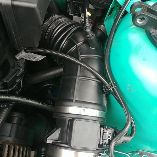

I know there are some threads on this already but nothing in detail and I've got some questions particularly for @gookah and @Antm72
I've just had my manifold swapped and although I could tell the difference driving it I really don't like the installation:
I've had to ditch my Dinan Strut Brace because the DISA is now in the way
The manifold (E46 330i) distribution rail had an extra connector (vacuum?) at the rear so we had to swap over the distribution rail from my 2.8 manifold - anyone know where that was supposed to go?
The manifold adapter I bought on eBay from Bimmertune and it was not what I expected - I had to get an engineering company to make the countersinks deeper so that the screw heads sat flush, I had to file a bit of the manifold opening away as there was a lip and according to the mechanic the throttle body was difficult to fit.
I had brand new BMW throttle body & MAF bends fitted and they are squashed up against the strut tower.
A part that attaches below the throttle body won't fit the bracket it's meant to be attached to because of the throttle body being further away from the manifold.
So, for those who have fine this mod, are my issues correct or have I done something wrong? Pictures below.
