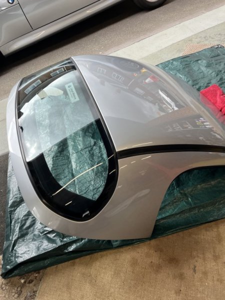

Iam getting ready to list my hardtop for sale and need some advice.
It’s off 1999 pre facelift with electric power hood and providing its going to pose no major issues I will include heated switch with loom.

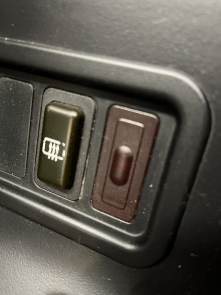

Update
Demister switch removed and unplugged.
No further wiring required and electric hood working fine.
Thanks again Stephen and BJ.

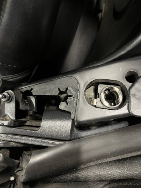

Been trying to find pictures of these parts and how they look in situ,ie on car without hardtop fixing kit.
Will not need parts until impending sale of hardtop,advertising

Just to confirm - removing the switch is not an issue - it just unclips from the connector which remains under the center console. The loom that I meantion is up on the bracket at the passenger side.
From factory, obviously the fitting kit is not there and the soft top wiring is hidden under the trim. The wiring for the soft top motor is split into 2 parts with a male and female connector joining them. When you add the fitting kit, you split these connectors and insert the small loom in the middle. This retains the operation of the soft top motor whilst also putting power to the rear demist. The power to the demist comes from the button (obviously) and to the hardtop window via that small connector (part 5)
