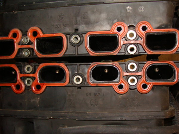

Not much has been done for the smaller sized 6 cylinder engines. Having both time and parts, I recently installed a M54B25 inlet manifold on a M52TUB25 powered BMW 323 to see what the improvements are. While the car is not a Z3, the results can be used as a guide for the 2.0 L Z3's as all M52TUB engines (2.0, 2.5, 2.8) use the same inlet manifold. I chose the M54B25 manifold as it was in the shed and getting another one for my Z3 would be cheaper than the popular M54B30 manifold.
It resulted in gaining 3% more torque and 6% more power plus the engine with the M54B25 manifold accelerated 38% faster during the tests.
The data was captured using the app "TestO" and can be seen in the attached graph.
The differences between the two manifolds are:
- The M54 runners are 10 mm shorter
- The M54 runner openings are "D" shaped and match the shape of the opening in the head, where as the M52 openings are Oval (see photo)
- The M54 DISA valve is larger
- The M54 resonant air sections are larger
All this results in letting the engine breath better. The 38% increase is acceleration is likely due to there being a better air supply which reduces the syringe affect as described by @Pingu in post 44 of his testing thread https://zroadster.org/threads/testo-datalogger-what-do-you-think.18350/page-3#post-319060
Now planning on doing the same mod to my 2.0 L Z3 in the near future.
