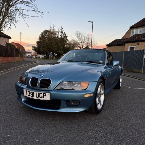

Just like to introduce myself and Z3 as newbies to the club.
I have long liked the “true” wide body Z3 (pre-facelift!) with its gorgeous curved rear quarters, and wide rim wheels all round. So, earlier this year I finally found a very late, March 1999, pre-facelift 2.8 with the improved (Edit: M52B28TU engine - not M54B28) with bodywork in exceptionally good condition and relatively low mileage @ 67k miles.
The drive home revealed a few home truths about a 25 year old car compared to our current daily drives!
The handling is atrocious! It tramlines and wanders all over the road!
There is no cruise control- I use it extensively: on long motorway journeys it makes driving so much more relaxed, whilst driving through towns with (ridiculously?) difficult to maintain 20mph speed limits, so much easier.
The standard leather seats are not particularly comfortable, supportive, or conducive to spirited driving.
Lacking air conditioning was a big revelation/disappointment!
We have become so used to having it that it took me back to my early days of long journey driving, with windows up, windows down, roof down, roof up , windows down, ………..

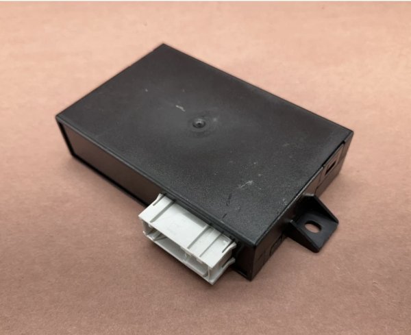

Yes there are just 3 components for a manual car:
The column switch (I could only find them available used
The control module. - on EBay UK
and the clutch switch - to cancel cruise if you change gear) - again on EBay UK.

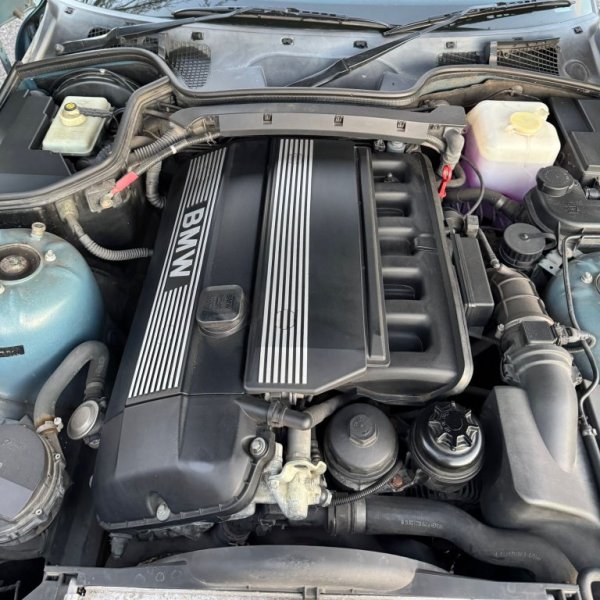

All M52TU engines have cable accelerators, but the cable operates an electronic actuator on the throttle body making them drive by wire.

After your post you had me thinking i was going a bit off in my old age so out came the torch and went for a look and can say categorically 100% my M52b28tu has a throttle cable that goes from the pedal to the throttle body and is definitely not drive by wire.
You will find this with the last of the pre face-lift and first of the face-lift models are a bit hybrid in their bits .

So if they have a cable operated electronic throttle body then the full drive by wire cruise set up of the m54 still works .
Stephen
Yes
I will try to take a photo of my throttlebody for you to confirm it’s the same as yours.
Hi Steve
My accelerator cable to the throttle body: it does not mechanically open the throttle, rather it activates the potentiometer which then tells the throttle actuator to open the throttle.
Hence it is very easy to add cruise control to a M52Tu.
