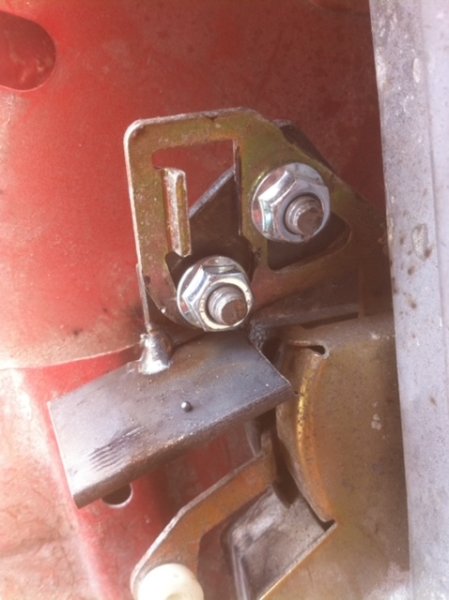

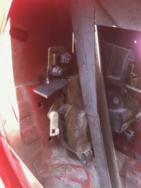

As many questions are being asked about handles and locks, here’s a thread that may help
If this lever does not fully retract, the car will not open using the central locking. The Alfa handle I tried had approx 10mm ‘Push’ which is not enough to allow the lever to go back.
The herald has about 16mm ‘push’ so works well

Open the door, open window. close it with the handle lifted.
Lock car,
Try opening from inside, it will be deadlocked
Until you release the outer handle, it shouldn’t open.

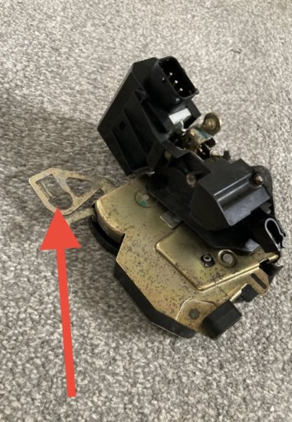

The gold lever shown above has to fully retract to allow the door to unlock.
I will check to see if I still have the door internal video I took showing how my mechanism failed to work. I was only about 2 mm short of the gold lever fully returning, but no matter how I moved the different fulcrum points I could not gain the extra bit of distance I needed

Deadlocking is that you cannot open the door, inside, outside with the key in the ignition. you can try what you want but if the car is deadlocked the only way is to use the BMW key in the outer door lock or lift the lever marked in Dxboltons post above.
Do not confuse deadlocking with simply locking the car with the remote they are very different.

So under what circumstances would a Z3 be 'deadlocked' and what triggers it?
If you look at the photos, if the big gold lever does not FULLY retract to its closed position, the central locking will not allow the car to open.
It only has to be a 1mm away from full retraction and the car won’t open
