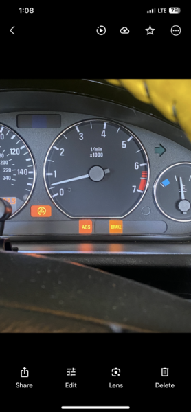

Started my Z3 yesterday and got lite with these lights on my dash. Has anyone experienced the same? So frustrating!! Tried restarting a few times but they didn’t go away. Any help would be appreciated. TIA

Easiest fix and check is that one of the wheel speed sensors is giving a faulty reading
Toughest your abs module is bad.

As @Zephyr has said probably a sensor problem or if unfortunate a pump module issue.
The first thing is definitely a code read of the fault memory.
Code readers are usually 16 pin obd
to get functionality from a zed 3 you will need to buy a 16 pin to round 20 pin adapter as you will need to use the 20 pin obd port in the engine bay to gain module access.
Once you have the fault code this will allow you to go straight to the source of the problem rather than guessing.
