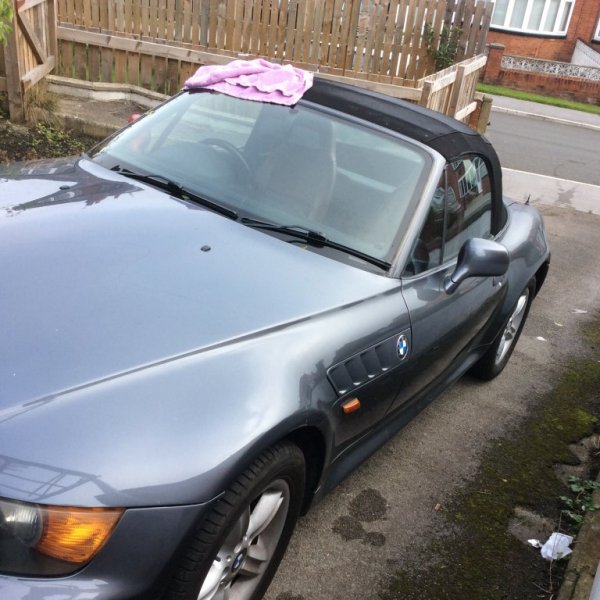

Meet CrissZelda my first lil z3 I've had her a year now and I think it's time to give her some real TLC. There's alot off work to be done and I plan to document my progress so if anyone's interested watch this space. I've taken some pics as she stands now with a list off what needs attention. Please feel free to comment as this is my first project and any and all help is appreciated. Plan is to start with cosmetic learn what I can from the forum then hopefully upgrade the mechanical stuff [emoji16].
Some unwanted red paint to be removed
Wing mirror to be sorted electric mirror not working
Interior could do with attention
Some roof repairs
Electric Drivers seat not working
Knock sensor error codes popping up
Am sure there will be more as I go along [emoji19]

Welcome aboard, looks like you got the usual faults! Door mirror will more than likely be corroded on the inside and will snap if you try to fold it in. Drivers seat not working could well be that the gears have failed. All part of owning one of these brilliant little cars! Good luck with your mission, may see you on some meets. :mad::)

I have practically the identical wear on the red trim of my steering wheel (same colour and everything). Does anyone know if this bit of trim can be removed without going down the battery disconnect and airbag out road? Was thinking of just going plasti-dip black on it as no idea where I would get matching paint for this colour.
