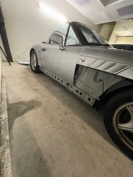

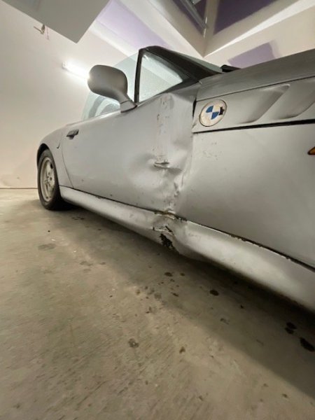

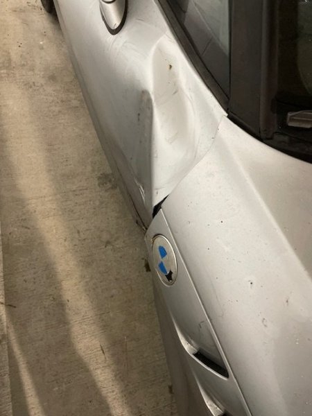

UNFORTUNATELY, one day while the roads were wet and my tires were bald, I went a little too hard around a corner and ended up becoming very acquainted with a tree on my passenger side. Lol.

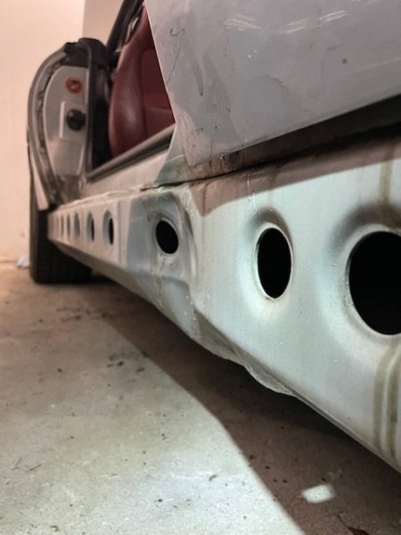

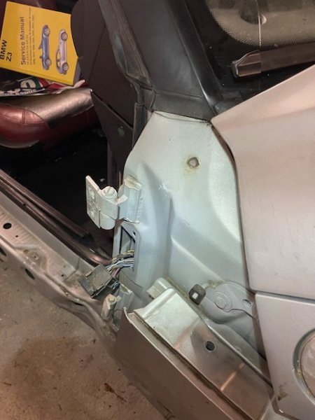

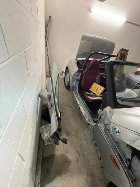

The passenger door was cooked, the lower rocker was donezo, and the windshield cracked at the A-pillar. I was able to drive the poor 1.9 home, and luckily none of the driving aspects were affectedâno leaks, still starts right up. However, once I removed the passenger door and lower rocker panel, the true damage became evident. The chassis was dented to hell, and the lower door hinge had been pushed inward so far that even after finding a color-matched replacement door from a junkyard, it would no longer align.
The A-pillar had shifted a few millimetersâjust enough to crack the windshield and prevent the top dowel from lining up with its hole. That meant I could never properly close the soft top again.
I took it to a body shop for a quote: $2,500 just to pull the hinge and A-pillar. No painting, no extras, and no guarantee that things would align properly afterward. Not to mention that after replacing the windshield, there was a good chance the first pothole I hit would just crack it again since the A-pillar was no longer in its factory position.

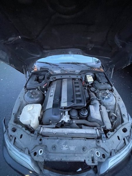

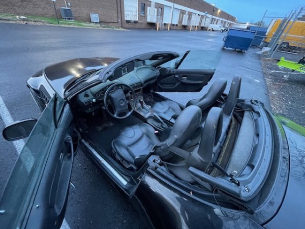

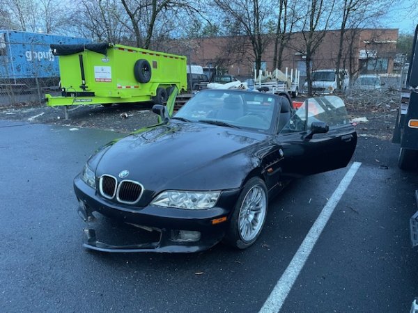

A 1999 2.5L inline-6 Z3 roadster with 60k miles, black paint, black interior, and black sport seats (SCORE!!). It also had 18â M-badged wheels (I suspect theyâre reps⊠but thatâs fine with me). The interior was very intact tooârear compartment, hoops, all that good stuff.
I was able to secure the deal for $2,300.

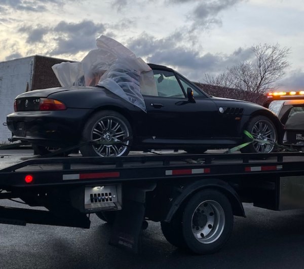

The bad part: it had clearly been sitting for a long time (I suspect something like 16 years⊠wow), though the seller couldnât confirm. I had to bring my own battery, and once I hooked it up the car started coming to life electronically. I didnât try cranking it thoughâthe oil was bone dry, so it had clearly leaked out over the years.
The tires were completely dry-rotted, so I had to tow it out. The rear window in the soft top was also totally gone, so I had to buy a car cover as a temporary solution since I donât have covered storage right now.
Ohâand itâs automatic (darn).
My current plan is to get the 2.5 back to life and restore it to a âdaily-ableâ state. After that, Iâll start swapping over the relatively new suspension parts from the 1.9. Then Iâll start working on a manual conversion with a ZF. Meanwhile, Iâll be parting out the 1.9. The engine runs perfectly fine (133k miles), so hopefully I can sell that and recover some costs. Once I get my moneyâs worth from parting it out, Iâll scrap the rest.
