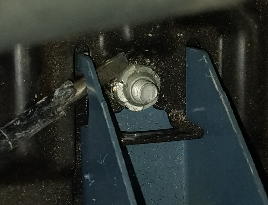

On my car the siren mounting bracket is welded to the back of the front nearside wheel arch and the siren is covered with a protective metal shield.
It is obscured by the main fuse box and was attached by a tamperproof nut so it is fairly inaccessible but I guess that's the idea.
I tried to undo the nut with a small pair of mole grips without success however BMW helpfully left a small rectangular cut-out in the side of the mounting bracket and by inserting a sharp, flat head screwdriver through this slot I was able to dig the corner of the blade into the nut then, using the cut-out as a fulcrum, lever it round.
Once released the siren can be unplugged and removed.
