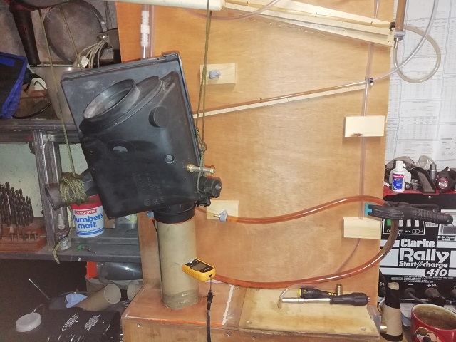

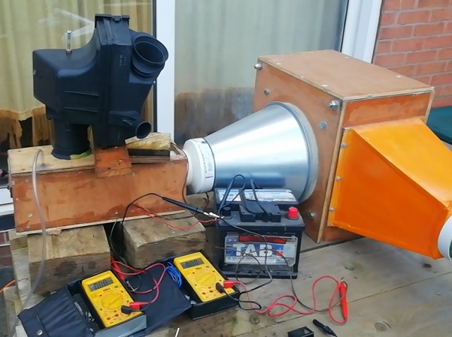

I built a flow bench to measure the flow rate through the air filter box...
but this rig would only measure comparative differences.
So, I built another rig. The data from this rig can be used to calculate actual flow rates...
I tested the standard air filter box and the volumetric flow rate was 444 CFM @ 28" H2O...

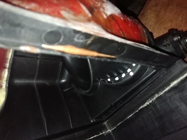

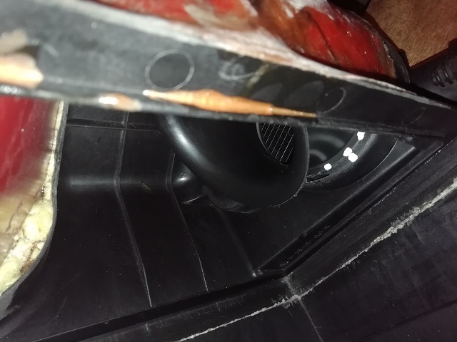

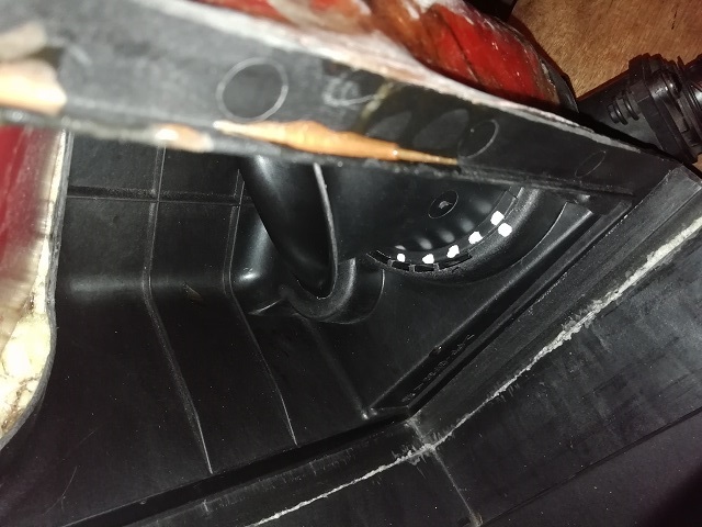

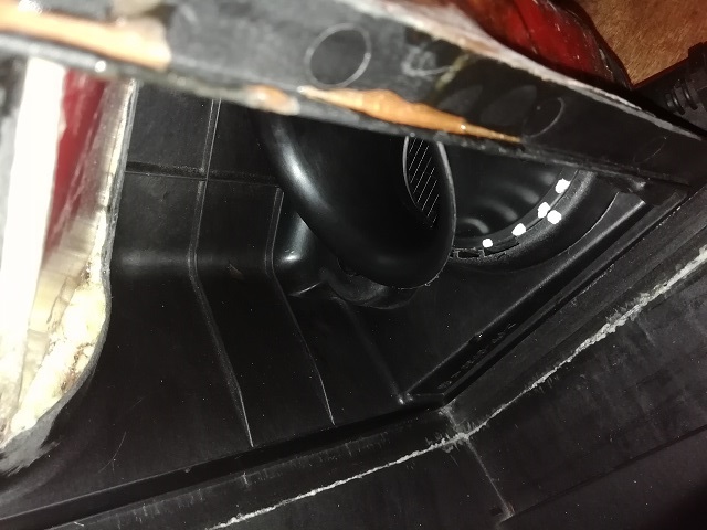

There is an obvious restriction at the front of the air filter box. Air has to squeeze through the hatched area...

I cut away the side and top of the box and increased the area that the air can flow through (the image shows the trumpet twisted to 60°)...
I used shaped steel and fibreglass to reshape the air filter box...

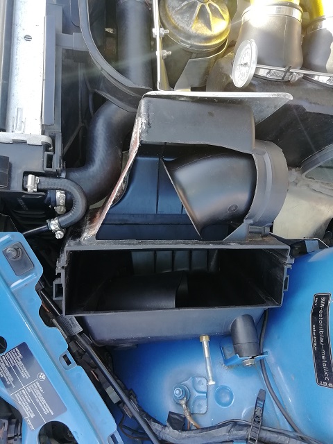

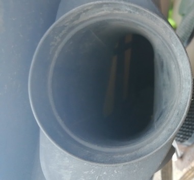

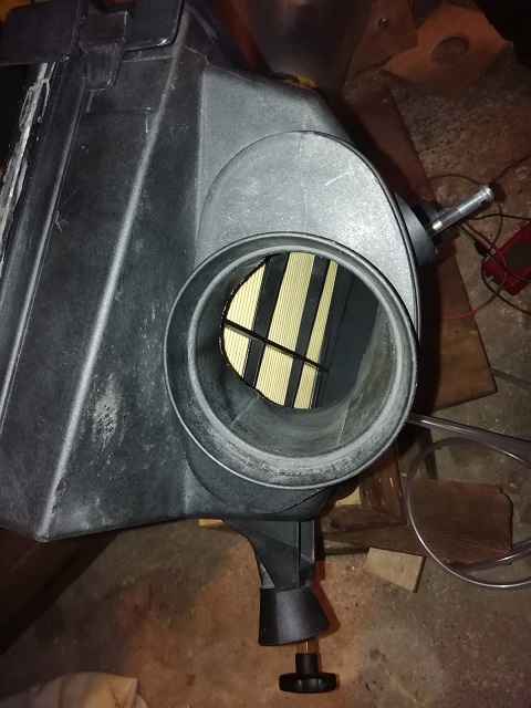

The final modifcation was to the intake tube. The standard intake tube directs air through a tube of diminishing cross-sectional area (4185 sq mm reduces to 3287 sq mm) to only one half of the air filter...

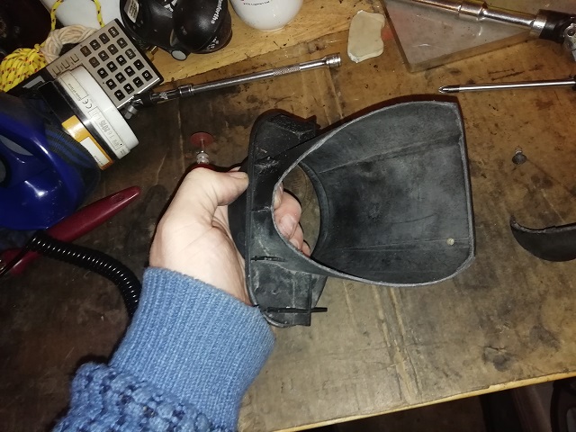

I removed the intake tube...
and cut away a large section of it...
The air is now directed towards a much larger area of the air filter...

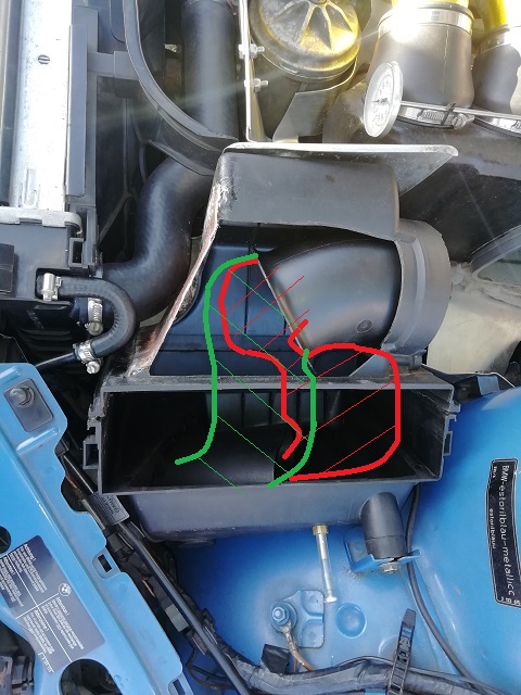

The standard air flow is shown in red and the new air flow is shown in green...
The air flow no longer doubles back on itself.

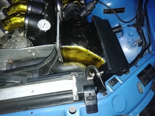

The modified air filter box fitted in the car...
