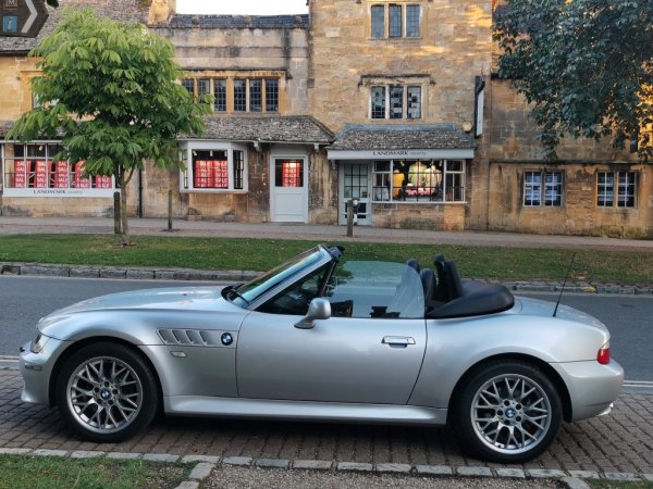

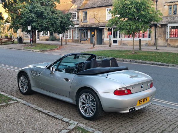

A little update from me the owner of this car a year on from when I picked up my Z3 3.0 from Lee's workshop near Basingstoke..
I had owned this car for two years prior, having bought an immaculate low mileage example which was produced in the last two months of Z3 production..It's a sport model which apart from meaning it had all the bells and whistles fitted as standard, it has special sports M suspension fitted which is a bit firmer than the standard Z3 but not as firm as the Z3M model. It looked and went ok and had never let me down but I never felt that entirely confident with the handling..It had that judder/shake rattle & roll going over uneven roads from the front wheels and more disconcertingly had a slight feel of being on an elastic band when going on long sweeping bends which did not exactly inspire confidence..
We have a regular meeting of Z3s down at Cotwolds airport in the summer and last year I parked my Z3 next to another 3.0 owner.."Have you had your car sorted at Lee's yet?" enquired the owner?..He explained that despite his car passing an MOT he had taken it to the Zshed where Lee had literally transformed the way his car handled from being "a sack of potatoes enclosed in a rubber chassis" to something that had transformed into something "planted on rails and connected"
I was sceptical!..Yeah if you've spent all that money you are going to convince yourself it was money well spent irrespective of any major improvement I thought to myself!! :)
Anyway in the end I did end up taking it to the Zshed and asked Lee to overhaul the suspension and do any other work to the car he saw fit as the car is a keeper and my plan is to own it for many years.
Lee showed me (despite my car having passed an MOT with no advisories the previous week) that the rear beam bushes were completely shot..According to him unless they have been replaced already on a Z3 virtually all Z3s that come into his workshop have these rubber bushes deteriorated to an extent they need replacing (my car had only done 65,000 miles but is 23 years old)
The lower suspension arms "Lollipop" bushes were worn and I supplied Lee with genuine BMW supplied late Z3M /E35 M3 concentric rubber bushes..These are not solid like the early Z3 M bushes but have less holes than the standard Z3 lollipop bushes. My car has 17" rims as standard and these replacement bushes have worked well for me (not too harsh, not too soft) although I understand some folk prefer going the poly route.
...Anyway the day I picked up the car I asked Lee how it would feel before getting in it..He commented that it would feel as if it was sitting a bit higher at the back (this was because my old rear beam bushes had dropped)..... I got in the car to drive back to the Midlands
And
WOW! An incredible difference..It's like a totally different car to drive and the enjoyment factor has increased by 100%..The handling now inspires confidence where safe for spirited driving. The gear change is smooth whereas before it had been notchy . Zero tramlining (Tyres not changed and running on existing)
A year late I've now covered over 3,500 trouble free miles. We have been all over the UK in it and next year a trip on the continent is planned. I can honestly say I never imagined a suspension overhaul could transform a car so much. Please bear in mind this was an immaculate low mileage car that we were starting from and not a high mileage neglected example..Basically these cars are now at least 22 years old and the original rubbers on the bushes on mine had has worn through age & shock absorbers were also not doing what they did when new.
I do wonder whether peoples views on the handling ability of Z3s has been made by either them driving or a friend driving a tired example ?
All I can say is that whether you take it to the Zshed or elsewhere or DIY, check out the wear on your suspension as a refresh can transform the enjoyment of your ownership of a Z3
Thanks Lee really appreciated what you did on my car ....
