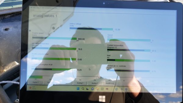

Hm… so these values are taken from a warm engine (needle to the center) and on idle at about 780/850 revs, correct?
if this is the case, and you would like to further dig further into your engine, please put your MAF readings.
I suspect you are having either a vacuum leak, or some erratic oxygen sensor issue.
I had the exact problem and almost replaced half the sensors (pcv, idv, coil, wires, cleaned injectors, etc) but finally after the advice of a certified tech, I smoke tested the engine, replaced the injector hoses that were leaking, the broken return hose from the valve cover to the air filter and finally the idle control valve and cleaned the maf.
Now my values are maxing at 0.50 (like your first cylinder) and I feel very happy about it.
it wasnt needed - the engine worked almost fine- but I did it just because…. ;-)
Zephyr
Aug 10, 2022
Having a value at the idle air consumption with engine off is a bit strange and that is why there is an exclamation mark there, but it seems ok with the engine running so no issue there.
your needed air is quite high, so lets wait for your sensor to arrive and read again.
i would remove and clean the idle air valve (please DO not pry it open as shown in some videos, it WILL break please please do not do it) just clean it with carb cleaner (spray and shake - repeat) and put it back using a new flange/gasket. And lets check again after the sensor arrives. Your engine is doing fine (from what these numbers say).
